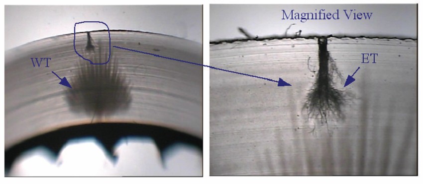

P:2008-12-22 20:39:12
给大家传个图片帮大家了解了解嘿嘿ie
